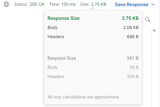

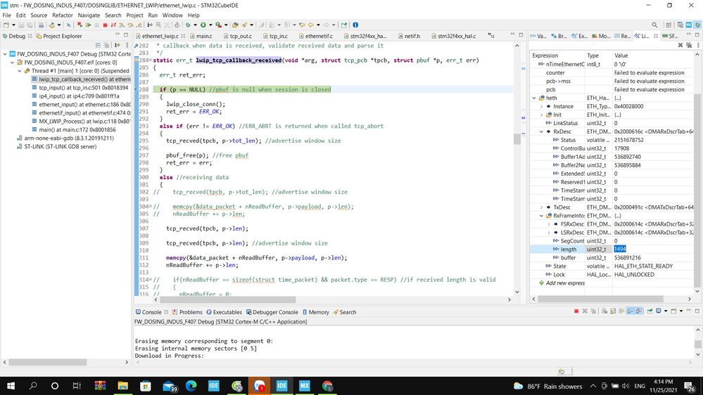

Thank you so much for this! But can I ask some little questions cause I'm so new to LwIP. Have you ever tried to receive a packet that has a size larger than TCP_MSS yet? I can not receive the whole response from the server (2.75KB), I just received only 1440 Bytes. Are there any ways to receive full the response data? Can someone help me with this?
