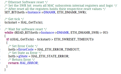

But ethernet is not being initialized. The HAL_ETH_Init is returning error which is resulting in error handler.
This is the condition being checked in MX_ETH_Init function. As even after using the steps mentioned in the article mentioned above the ethernet is not working.

@jowakar122 wrote:The HAL_ETH_Init is returning error
So what error, exactly, is it returning ?
Have you stepped into HAL_ETH_Init to see where and why it is failing ?

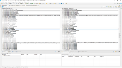

I downloaded example Nx_WebServer for STM32H573IIKX; comparing 2 .ioc, I noted that Ethernet frequency in your project is very different from STM example:
Any reason for this difference?
Also other settings are different, please double check.
Mike

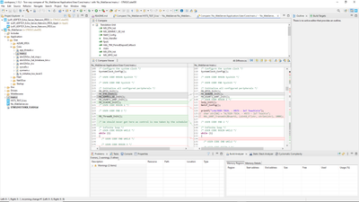

@mbarg.1 I tried after changing the Ethernet clock frequency as per the example and also initialized ethernet before calling Network_config. Yet same result
2025-05-20 4:24 AM
First: something MUST be the problem, never forget this; many people run this device without problems.
Next step is to see differences between your code and exampe I did attach to previous post.
Or add code of lwip_init() and let me try to understand what happens.
