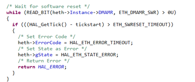

But ethernet is not being initialized. The HAL_ETH_Init is returning error which is resulting in error handler.
This is the condition being checked in MX_ETH_Init function. As even after using the steps mentioned in the article mentioned above the ethernet is not working.

@mbarg.1 I have tried that but still it is not working.
This where it is getting error inside the HAL_ETH_Init function. Moreover, there are no LWIP examples on STM32H573.

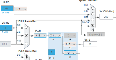

As I have mentioned above the issue lies due to wrong configuration of clock. Due to which the ETH_DMAMR_SWR is always SET.
Does anybody have any idea regarding this issue.

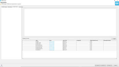

For examples, see "X-cube-classic-coremw" on STMicroelectronics github:
STM32H573:
STM32H563 (more examples, should be easily adaptable to STM32H573):
2025-05-20 1:41 AM
