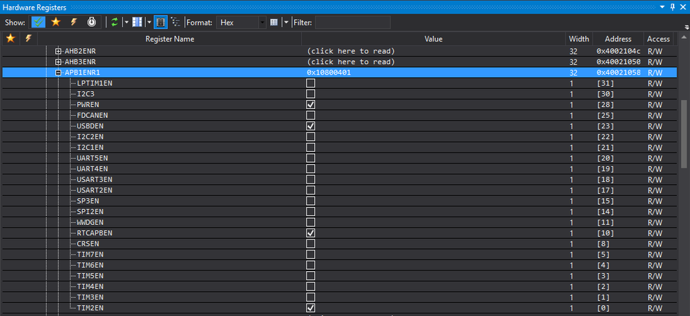

I've verified that RCC->APB1ENR1->USBDEN is set. (screenshot).

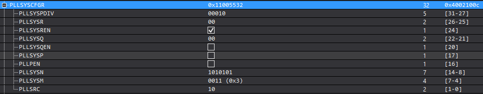

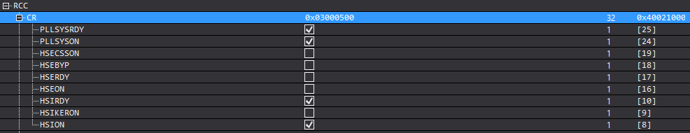

I'm using HSI (screenshot of RCC->CR). (screenshot)

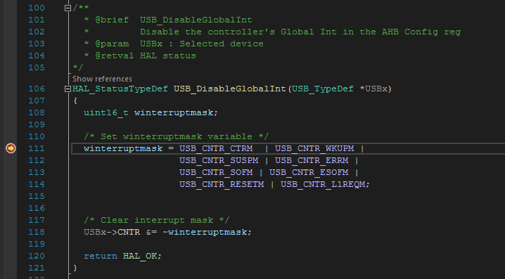

Crashing Source Code Segment:

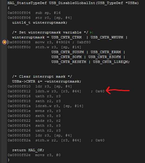

Disassembly

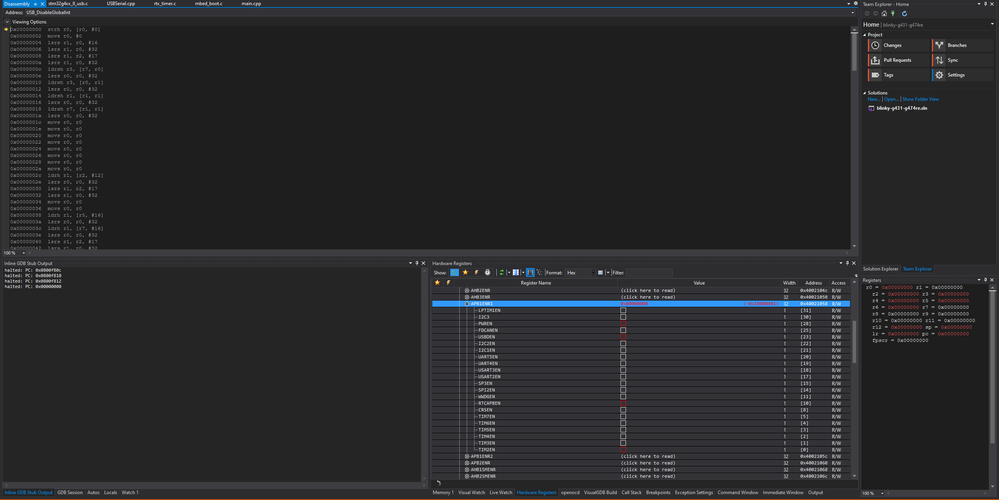

CPU Registers before crash
Fatal Crash (after executing ldhr.w instruction (i.e. reading USB_CNTR@0x40005c40)
I also get a crash if I use the debugger to read that memory space.
APB1ENR1 (I.e. USB clock enabled)

RCC->CR (i.e. HSI mode selected)
RCC->PLLCFGR (i.e. HSI Mode and clock configuration)
