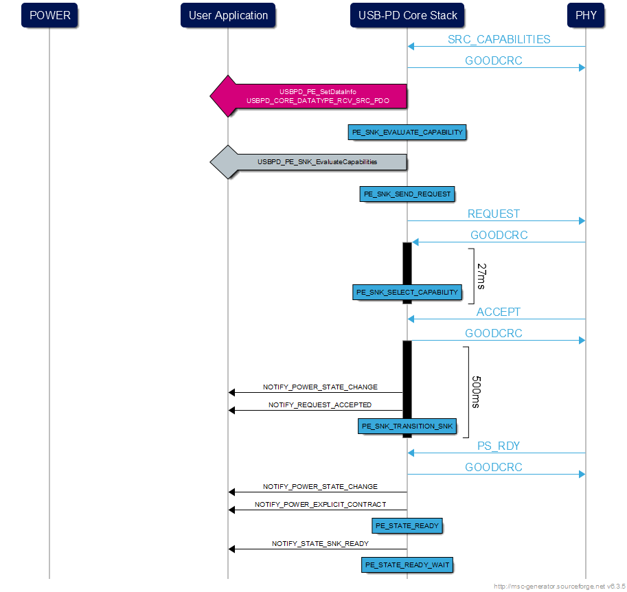

Dear Stefano,
Happy to see that you are progressing in your setup.
I remind here the expected sink power negotiation (described in UM2552 as well):
I attached the NO_RTOS application based on G4.
DPM_Ports is defined in usbpd_dpm_user.c.
