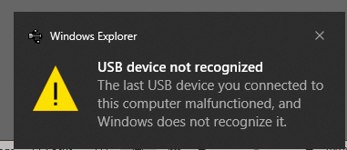

I'm using STM32G0B1-Nucleo (with no USB user connector), and I am trying to program USB device (I tried virtual COM, HID and MSC separately).
I'm using the STM32CubeMx with STM32CubeG0 FW V1.5.1 to generate the configuration with PA12 and PA11 for D+ and D-.
But after plugging into PC it is detected (after a while) with "Unknown device (device descriptor request failed)" error. (see img bellow)
