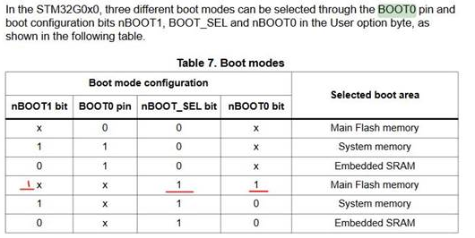

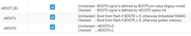

This is what the default MCU configuration is:
With these bits set, the BOOT0 pin cannot be used to put the MCU in bootloader mode (once its application flash area is non empty) because:

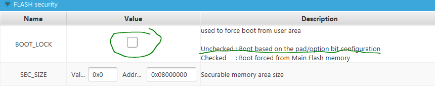

That's not how engineering issues are addressed. We need to find the root cause of the issue to make sure this doesn't happen again. Your suggestion of triggering bootloader from the Application firmware will also require the BOOT_LOCK bit to be programmed in the application firmware (at least once) because by default it is unchecked:
So the original issue and the requirement remains. How to safely write to the option bytes
