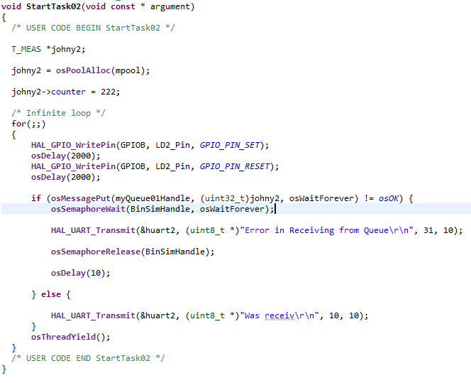

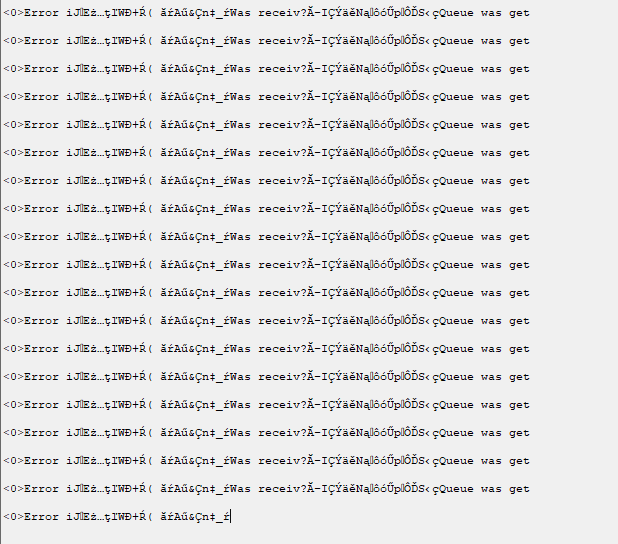

I want the information in one thread to be processed, and the second thread to be sent via UART. I made a small template where I send pseudo data via UART. But my information does not come in the right way. I think it has to do with interrupts. I used semaphores but it didn't help.
2022-03-05 1:04 AM
UART does not have time to send a full message with the phrase "Error in Receiving Queue\r\n". The program goes on. How to make sure that the message has time to come?

A 10ms timeout seems too low. What is the baud rate?
The string lengths your sending do not include the trailing /r/n on the second call.
Calls should work just fine otherwise. Perhaps you are sending data in other threads as well. The output doesn't like up exactly with what you're sending.
