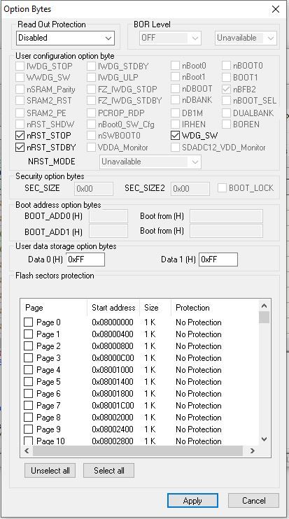

I already used this step to update other MCU (STM32F030RC and STM32F072C8) and it working well.

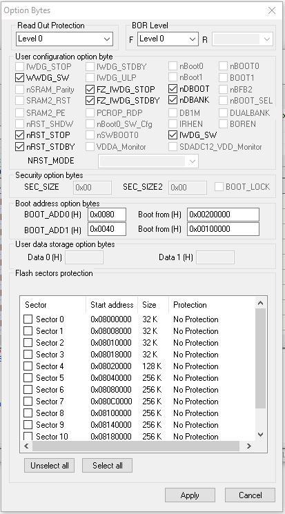

2021-02-08 11:43 PM
I know what you mean but we don't have 'intelligent' component which can send data by itself.
There are a lot of peripheral which can be used with the embedded bootloader and we cannot reserved this pins to be sure they will don't disturb the bootloader. The user firmware need this this pins.
I had check this pins and I don't see something which can be wrong.
I also checked the options bytes configuration and it seems good for the 2 boards.
I did a test with the Flash Loader Demonstrator from ST (with empty MCU FLASH or not) and I have the same issue, no response from the target, the bootloader cannot be started.
