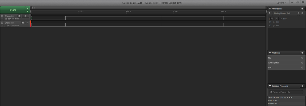

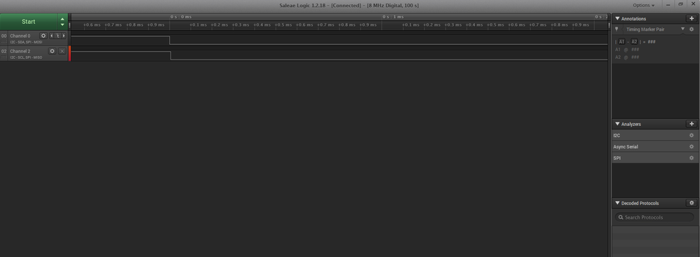

}But my problem comes earlyier, I would love to enter to "HAL_I2C_MasterTxCpltCallback"/"HAL_I2C_MasterTxCpltCallback", and it does, only from step by step debug.
For each data sent through i2c, I2C1_EV_IRQHandler is called few times: once per byte (and maybe to release i2c bus)
From step by step debug, and logic analyser, we can see the different bytes sent.
When running directly, I just set the lines from transmission, and boom.
This is when I run with no breakpoint (it remains like that and there is really no signal even very fast)
when running step by step, it's very slooow, but it works better (it still finishes by a hardfault, maybe from mutex I'll deal with it later). Each 3 peaks are a byte sent from the same 3byte frame.
