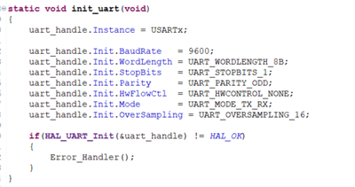

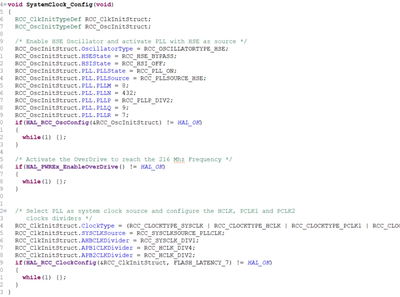

I have created my own example to print the data on HyperTerminal (putty) following the already given example "UART_Printf" but mine is only printing the first char of the data and then stuck forever.
Here is the clock config code
and uart config:
and what I would like to print:
let me know if you need more info.
Thanks,

Please use the code pasting tool, see icon </> rather than in-lining screen shots of code
Not sure what "message" is defined at, nor how the pins are configured, etc.
The fragment shown should be workable, perhaps look elsewhere for the actual issue.
Like the MSP code, or where ever you enable the clocks and pins, and peripheral, etc.
Is this a custom board?
Does it work if you just run with the default clock?
2025-02-07 9:20 AM
sizeof should go to line 110, and strlen to line 111. Where & how is message defined?

Hi Tesla,
it is my first question here (so was not familiar with how you guys would like to see the code) but anyways here is the entire main.c. @KnarfB you can see message[] is defined at line 105
@Tesla DeLorean mpu and clock_config are same as in the "UART_Printf" example code. I following the same same example project.
What I want to is achieve is printing the temperature on the terminal (so basically want to combine ADC temperature sensor and uart print example combined)
Note: Individual examples works but when I created my empty project (template) I am having the above mention isuse
Thanks
2025-02-07 10:51 AM
Check the return value of the HAL function call.
Use the most precise clock (HSE?) at a high clock rate to generate precise timing on the serial line.
Try another cable, terminal prog (TeraTerm) and/or computer.
Step into the HAL code, it is open source and try to find out what's going on.
Check the data on the wires using a cheap logic analyzer or scope.
hth
KnarfB
2025-02-07 11:02 AM
I'm not seeing a reason it should fail yet.
Show MSP code enabling UART and GPIO
Have something in Error_Handler() and HardFault_Handler() so can check it's not dying there.
Check SysTick() is working.
Stop in debugger once it fails, determine where it has stopped or is stuck.

@Tesla DeLorean here is the code for uart msp init
sometimes it stuck at:
tickstart = HAL_GetTick();
in HAL_UART_Transmit() function
