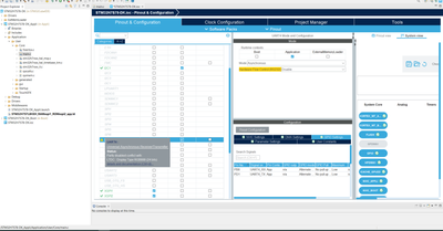

2024-11-26 7:45 PM
It doesn't work but I noticed something in the .ioc file seems like UART4 is conflict with LTDC.
here i attached screenshot of .ioc file,
Best regards,
Mehul
2024-11-27 3:32 AM
These warnings are generated by CubeMX as a precaution, and you can ignore them as long as CubeMx allows you to configure the UARTs with features that you need.
The conflict here is with Asynchronous mode. Try change this mode and it will work for you.
