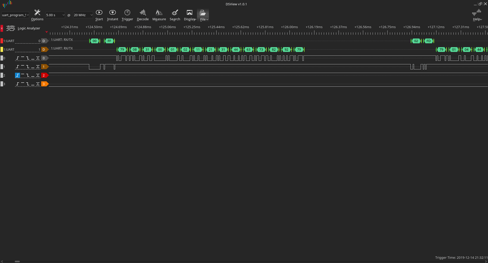

2019-12-14 1:45 PM
The STM32F serial programmer from Chipwhisperer doesn't write the extra XOR checksum, yet somehow works without it. When I write the commands to the serial port, it doesn't work without the extra checksum. But only "Get" works for me.
Chipwhisperer STM32F serial source: https://github.com/newaetech/chipwhisperer/blob/develop/software/chipwhisperer/hardware/naeusb/programmer_stm32fserial.py
Captured trace from logic analyzer for the Chipwhisperer STM32F serial programmer (you can see there is no extra XOR checksum that would make the XOR of all bytes == 0; channel 1 is TX, channel 0 is RX) :
