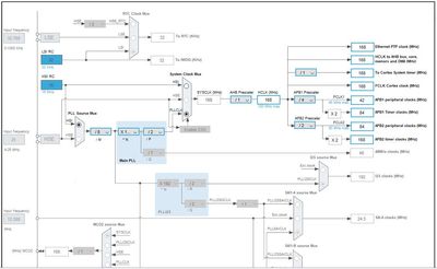

Below is a screenshot of the clock configuration:
When we probe the ETH_REF_CLK we see the line go high, clock for a small amount of time at the wrong frequency (~1.25khz) and then remain high afterwards.
