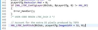

Yes, putting this after the LTDC init functions corrects the image. I still do not know why TGFX adds the 32 pixels of bogus at the end of each line.

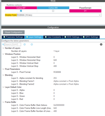

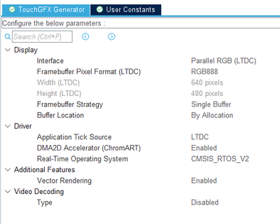

The project was created for the DISCO board, so those settings were not the same. I updated the LTDC and TGFX settings in CubeMX, and those changes are reflected in what Designer shows. Not shown in the screenshots is that the LTDC GPIO speed are all set to very high.

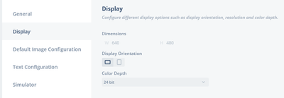

2023-08-08 11:00 AM - edited 2023-08-08 11:04 AM
Designer showing the right display dimensions:

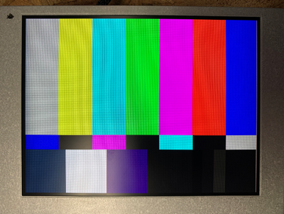

The image below was me using the generated image cpp file from Designer as a static framebuffer.

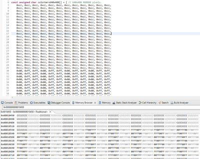

2023-08-08 12:10 PM - edited 2023-08-08 12:12 PM
I have already tested the manual framebuffer plenty of times.

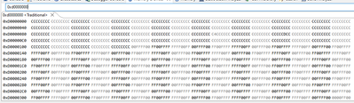

However, in the IDE I am not able to inspect memory contents, they are all question marks. When I did not involve the FreeRTOS and TGFX, I was able to inspect memory. So what I know is that the image files generated have the correct data, the LTDC is able to take whatever is in the framebuffer and put it out to the display if the data is correct, but what's left is I don't know the data being put there in real-time.
I was able to inspect the leftover memory contents of the TGFX framebuffer location the next time I used a manual framebuffer location, and it appears that there are the same, correct contents. This may be suggesting that the TGFX engine output may be correct.
Manual framebuffer and data:
TGFX framebuffer location:
