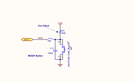

So there must be something wrong with the reset arrangements in your hardware
2024-01-29 3:11 AM

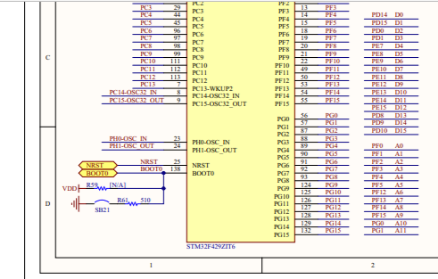

I have shorted SB1 and R24 in the Reset section and SB21 is shorted to ground and left R59 open on the F429 controller side.
2024-01-29 3:21 AM - edited 2024-01-29 3:27 AM
You've shorted R24?
You mean NRST is connected direct to VDD??! :flushed_face:

You said it's a custom board, but that looks very much like an ST devboard schematic? :thinking_face:
2024-01-29 6:49 PM - edited 2024-01-30 10:40 PM
Made custom board same as stm32f4 disc1. Sorry, I was confused R24 is connected to 100K but it shows not fit in the schematic.
