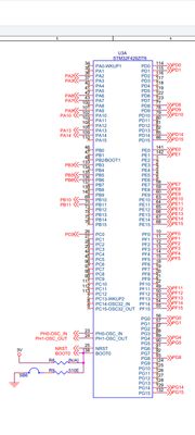

I'm want to send a string from one stm32 to another stm32 to blink an led on it I'm using uart polling method to do that.
The communication happens and led blinks only if I press the Reset button once I switch off and on power supply. What should be done if I want continuous communication.

Still lacking detail - that shows us nothing other than BOOT0 is connected to ground.
How about posting the code you have?

is this a custom board? BOOT0 pulled Low?
Try to provide some more detail rather than symptom.
2024-01-25 5:25 AM
Yes it's a custom board and. Boot0 is pulled low.
2024-01-25 6:26 AM

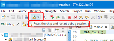

Well, that code should transmit continuously in a loop.
Does it run under debug?
BTW: you've marked by previous reply as The Solution - but I don't think it solves your problem?
2024-01-26 11:26 PM - edited 2024-01-26 11:27 PM
Yes the code runs under debug once the supply is made off and on the code works after i press the reset button on any of the two board.
BTW: you've marked by previous reply as The Solution - but I don't think it solves your problem? I clicked it by mistake.
2024-01-27 5:08 AM - edited 2024-01-27 5:10 AM
@harry123 wrote:Yes the code runs under debug once the supply is made off and on the code works after i press the reset button on any of the two board.
I mean if you run it within the debugger in the IDE - does the restart button within the debugger successfully restart the code?
@harry123 wrote:I clicked it by mistake.
Once you've clicked it, you have the option to undo that ...
2024-01-28 9:38 PM
Yes it works
