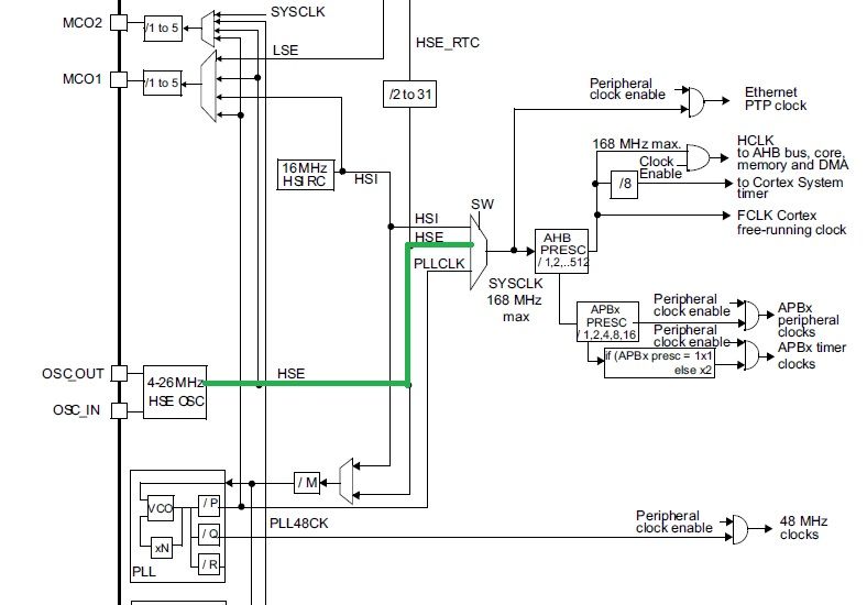

Clive,
Is there anyway to bypass the PLL? Because that is the limiter on 50 MHz. Else even high frequencies can be fed externally?2014-10-27 11:20 AM
Look you can select HSE as a direct source to clock the processor. The oscillator is specified from 4 to 26 MHz, the external source from 1 to 50 MHz, outside that you're in uncharted territory. USB and SDIO require the PLL
