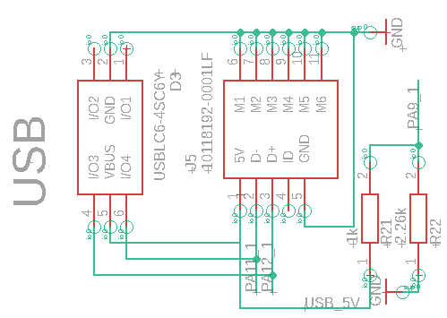

I want to use the factory USB DFU bootloader for production programming. I have set BOOT0 to 1 and BOOT1 to 0, powered on the board, and plugged in the USB, and in device manager I get an unknown device (device descriptor request failed). I am not sure what I am doing wrong.
Schematics are as follows:
Is there anything I am missing? I'm sure I followed AN4879 well enough for it to work...
2022-04-25 9:22 AM
Ah, it would appear I overlooked the fact that I have a CAN transciever on PA11 & PA12. Removing that makes it work, but it takes quite a long time for the STM32 BOOTLOADER to appear in device manager. Any reason why that is?
