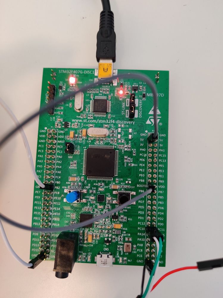

So here's the thing: I've been getting familiar with flashing the STM32F407 discovery board using the in-build bootloader via USART3. Boot mode is set to System memory using
Boot0 = 1 (5V)
Boot1 = 0 (GND)
I am using an USB to serial converter. Connection is:
USB_serial_TX (Green wire) <=> MCU_RX (PC11)
USB_serial_RX (White wire) <=> MCU_TX (PC10)

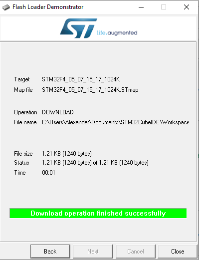

When using the bootloader to upload a program to control an LCD via I2C, I get the expected result. However, when trying to run a simple GP timer to control an LED, the LED does not blink.
The code itself works, because when using the on-board STLink programmer, the LED blinks. Just with the bootloader, it does not. Any ideas? Thank you.
