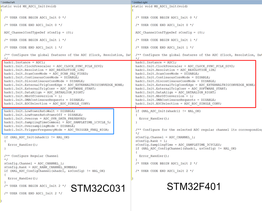

2025-09-03 9:23 PM
You don't have to worry about the register maps. Using ST's ADC init data structure will set the registers correctly.
Majority of the ADC is the same between the two shown in the red box.
The C031 has some extra stuff in the blue box, which half are disabled. Just matching what's in the red box should get your going. You just have to choose the sampling time which are in the Ranks for the F401.
