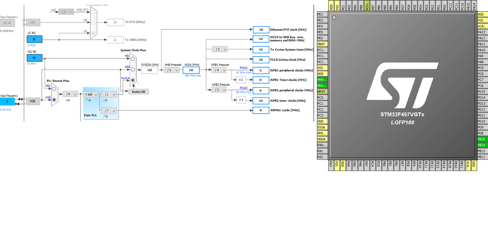

I have configured it in Internal Phy only where i will get Speed of 12 Mbps which is sufficient for my application. Do i Need to connect external phy also if i want to use 12 Mbps Speed (As per Manual i think No)?? I had checked my d+ & d- Signals on PB14 & PB15 resp. But i am getting some wiered Output.
I have attached my clock configuration & pinout.
2017-04-20 11:58 PM
No you only need texternal phy for usb 2.0 speeds, AFAIK!
