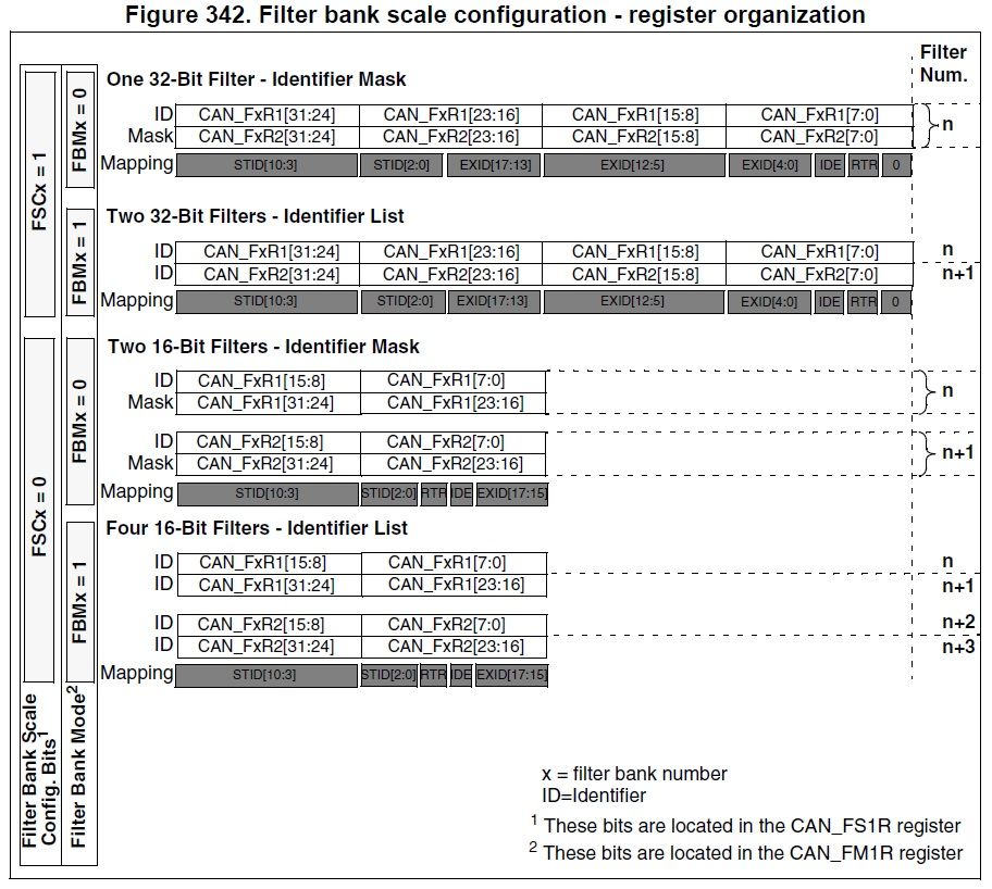

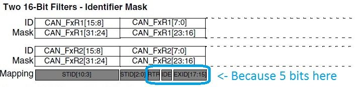

Posted on April 26, 2017 at 17:48
But why there's a shift of 5 if the register start from 0?
16bit: CAN_FxR1[15:8] + CAN_FxR1[7:0]
why it can work only with CAN_ID<<5?
Thanks
Posted on April 26, 2017 at 18:44
Look, because the STID is in the TOP 11-bits of the register, and the data on the wire is filling the most significant bits first, moving Left-to-Right on the diagrams
