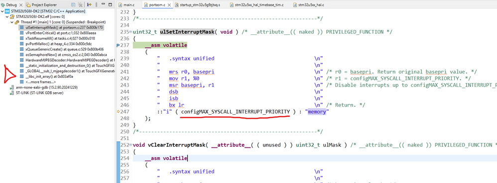

2026-03-30 4:28 AM
@Pavel A. Yes, That is how I found the casue of HALTick not running. I could not find use of CMSIS::__set_BASEPRI() anywhere in my code, but there is a static allocation of FreeRTOS semaphore in MJPEG static instance i.e. before main(). Thanks for a hint.
