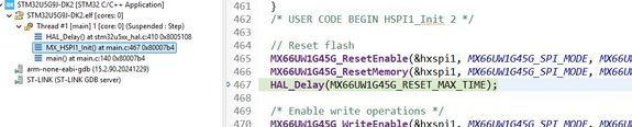

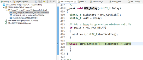

>> "But wanted to confirm my understanding: in the old HAL implementation the systick priority was 0 and in the new implementation the priority is set to 15 which is not working, and setting it to 0 works again?"
Exaclety. TIM6 prio has changed to 15 (was 0) and with that change, HAL_IncTick() is not called.
As soon as i set TIM6 priority to number 4 or less, the system works. So it seems it has sth to do with that number 5 that sets boundary between "RTOS aware IRQs" and the "rest". I am trying to understand what is masking the TIM6 IRQ. The RTOS initialisation is executed only after HAL modules initialisation so it is not RTOS, I think.
With TIM6 IRQ priority set to 5(or higher), my program waits at delay and HAL_GetTick() returns always 0.

2026-03-30 3:41 AM
In you main(), before anything else, try to call __set_BASEPRI(0)
int main(void)
/* USER CODE BEGIN 1 */
__set_BASEPRI(0);
/* USER CODE END 1 */
2026-03-30 4:22 AM
Something can call a function that internally uses a RTOS lock (for example, malloc) while the scheduler is not started yet. For FreeRTOS, in some configuration, these locks raise BASEPRI.
