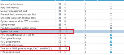

But wanted to confirm my understanding: in the old HAL implementation the systick priority was 0 and in the new implementation the priority is set to 15 which is not working, and setting it to 0 works again?
Note that in the working project I shared with you Systick has the prio 15 (same as TIM6):

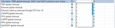

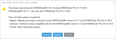

yes, setting TIM6 priority to 0 it works again. Anyway, it's not a change of HAL libraray. It depends on CubeMX version. If I open the old project CubeMX displays a warning since it was created using an old version of CubeMX.
In this version (5.1.0) time base source priority (TIM6) is set to 0 and I cannot change it, as you can see below. System tick timer priority is set to 15.
In the new version, that is the current one (6.11.1), TIM6 priority is set by default to 15, but I can change it. That's the thing I didn't get before. System tick timer priority is set to 15 as before.

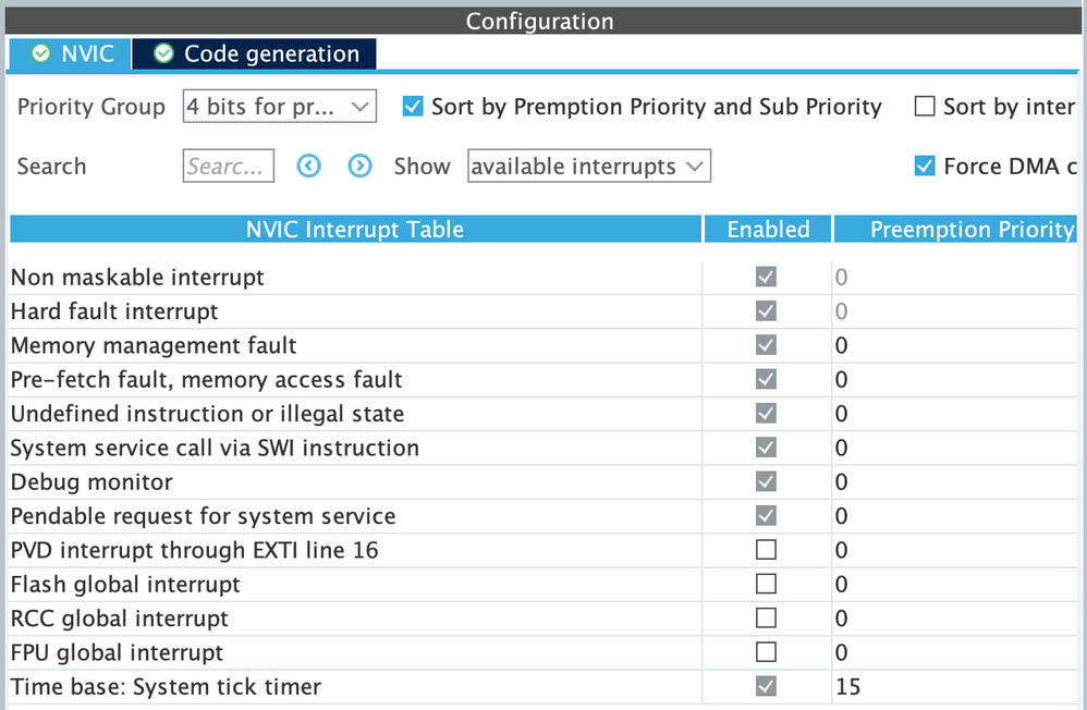

Why did the default system tick timer priority change from 0 to 15? This is a pretty dramatic change, and contradicts vast reams of documentation out there. I think it warrants some breadcrumbs at least, on what the motivation was, and what the implications are.

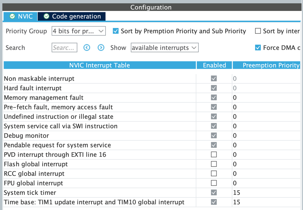

FWIW, I also discovered it adding FreeRTOS, but it turns out FreeRTOS is irrelevant - if I start a fresh project in CubeMX 6.15.0 for the STM32F413VGTx, "Time base: System tick timer" is priority 15 out of the box:
Furthermore, if I then change "Timebase Source" to TIM1 instead of Systick, then both interrupts get priority 15!
At the very least, this means that by default the HAL's tick count wont increase if any other ISR is running. That's fine if you know about it, but given the opposite assumption has been true since the dawn of time, it would seem this would cause umpteen issues. What have I missed?
