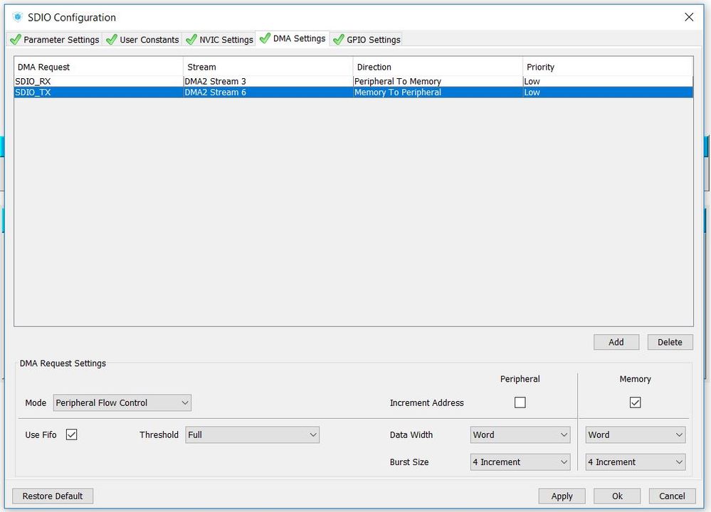

Thank you very much. I guess i will have questions later on when i will try to do it. So far i have working project configured using CubeMX sdio + fatfs. I will try to modify that to DMA approach. I guess it will consist only of configuring DMA + changing tohse two functions in
sd_diskio?
I am not sure about how to setup the DMA in the correct way. I will enclose snippet from cube mx regarding DMA setup for sdio. Maybe you can advice what options i do need to setup.2017-07-03 4:28 AM
Your configuration is correct, but you need to change both Rx and Tx DMA priority to 'Very High'.
Bests,
Misagh
