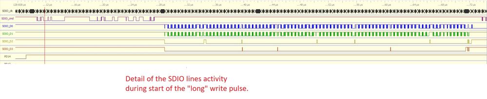

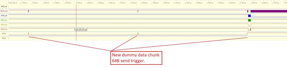

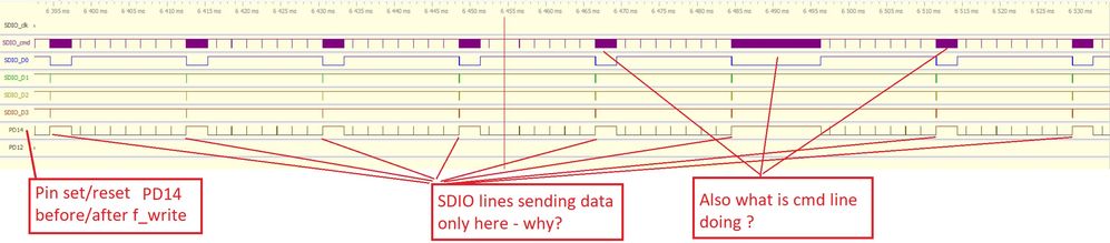

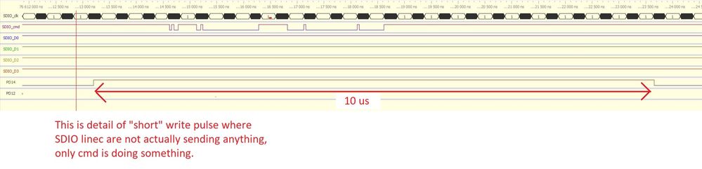

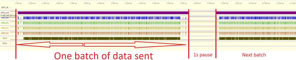

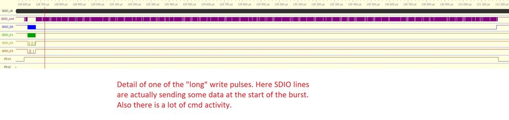

I am investigating my SDIO FATfs case further more. Here are some observations i have made so far:1) When i test sending the batches of dummy data (2500 chunks of 64 bytes with 2ms interval, then 1s pause and start over again) using only HAL_Delay for timing the application works reasonably well. I am able to open close hundreds of files writing one batch of dummy data into it.I have printed few digital analyser scopes made using ''HAL_Delay'' triggering method so you can observe signals. In my program i set/reset PD14 before/after every f_write() function. I have noticed, that only every 9th data chunk f_write() will cause SDIO lines to move and also it takes much longer time (looking at SD14 pin toggle told me). previous 8 writes only do only something with cmd line and it takes much less time inside f_write function (PD14 toggle).
2) When i go back to using my timer TIM6 PeriodElapsedCallback() for triggering of sending of 64B chunks soon enough (after few batches <each batch is written into separate file with incremented index name>) the f_write returns FR_DISK_ERR.
My theory is that somehow timer interrupt interfere with the 9th long writes? Is it that f_write function should not be interrupted? But if i am not mystaken, systick interrupt is also used for HAL_Delay() so what is the difference?
