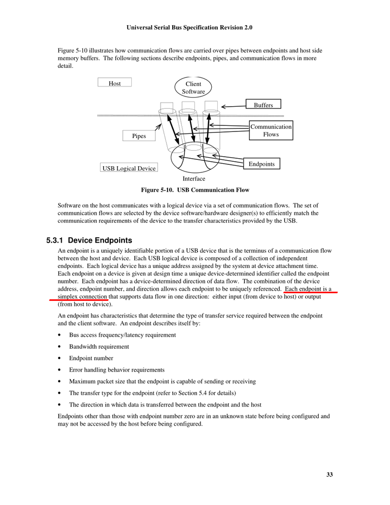

 I have a question how could CTR_RX and CTR_TX co-exist? Is not USB a half-duplex data I/O stream? That is, request/response in a lockstep arrangement.:thumbs_up::thumbs_up:
As I've said above:
> No. Endpoints are simplex and mutually independent. Or, from the horse's mouth:
0693W00000LyCsJQAV.pngI believe the rest that post above explains why the common misconception for "lockstep" (I wonder where this comes from, it must be a common source, I've heard this expression too many times in this context).
