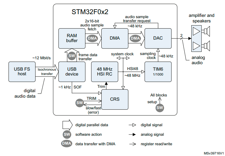

and when i was searching for the right STM32 MCU to get data from this connector, i found the STM32F0 that has inside a USB device as shown in the figure below.
is there any piece of help about this CLASS driver to base on or a helpful document to assume this USB communication?

USB device means that you can connect it to a USB host (for example a computer), not that you can connect other USB devices, such as your sensor.

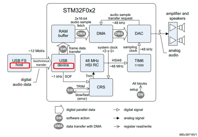

A USB connection always consists of a Host, and a Device (ignoring Hubs for now).
Your sensor is a USB Device - therefore you will need a USB Host to connect to it.
As it says in the diagram you posted, the STM32F0 is also a USB Device - it cannot connect to another USB Device.
