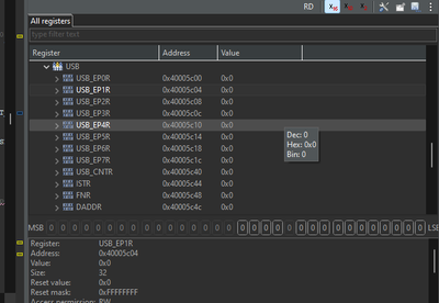

1.- What config must set to PA11/PA12 pins? I set ALTERNATE FUNCTION (0x10) in MODER register, but what AF option must set? In STM32F373 manual there is no AF defined.
2.- I configure USB device (clocks/gpio) and i can access to USB registers as ADDR,... but EPs seems inhibed? you know the reason why?

I did but have same result,
MX_USB_PCD_Init();
HAL_PCD_EP_Open(&hpcd_USB_FS, 0, 64, EP_TYPE_CTRL);
but EP0 no change values. EP0 -> 0x00.
I write bare metal and use debug (CUBEide) and i can't modify the Eps
How do you know?

Theorically, now USB is ready to accept configure the EPns. But when i try to do it i can't change them.
Use same code with STM32F042 (but not config PA12/PA11 as alternate) and run properly.
Any Idea?

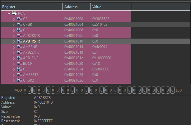

2024-03-03 2:41 AM
Thinks the same but theorically all clocks run as well
