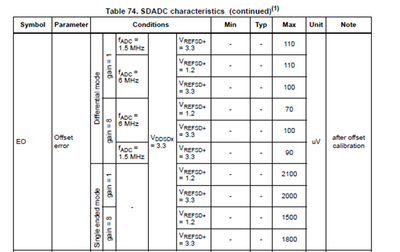

We want to use the SDADC to measure the temperature of a PT100 sensor. The measurement should have a very high accuracy of +-0.5Kelvin. Therefore, it is important to have a low offset error. The datasheet lists very large values for single-ended mode, e.g., 2000uV for VREFSD+=3.3.
Differential mode cannot be used because the number of channels would then be insufficient (We need 18 channels, and the STM32F3 has only 11 differential Channels).
There is a product lineup where the offset error is specified as < 1 LSB.
Why is the offset error specified in the datasheet so high in single-ended mode ?
Can it be reduced by using a buffer op-amp at the input ( The buffer op-amp would mean a very low source impedance and would reduce e.g. bias errors ) ?
I have also read the AN4207 section offset calibration, but there are no details about single ended or differential ended offset errors after calibration

We want to use single-ended mode because the hardware should support six PT sensors with 3-wire measurement, and there aren't enough pins available for differential-ended measurement.
We don't want to calibrate the ADC inputs at 2-3 points, as we do with the evaluation board and evaluation software (that would require additional effort during the end-of-line test, and we would prefer to use an external ADC).
When calibrating with an external reference, the input offset of a maximum of 1800uV at VREFSD+=3.3V can of course be detected and eliminated.
If this input offset cannot be calibrated, 1800uV can already mean a deviation of several degrees Kelvin,
depending on the current flowing through the PT sensor.
