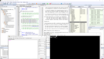

Here is a screenshot from debug view using latest version V1.4.0
Your issue is more likely linked to the version of CubeMX or the implementation. Would you share a failing and working project?
