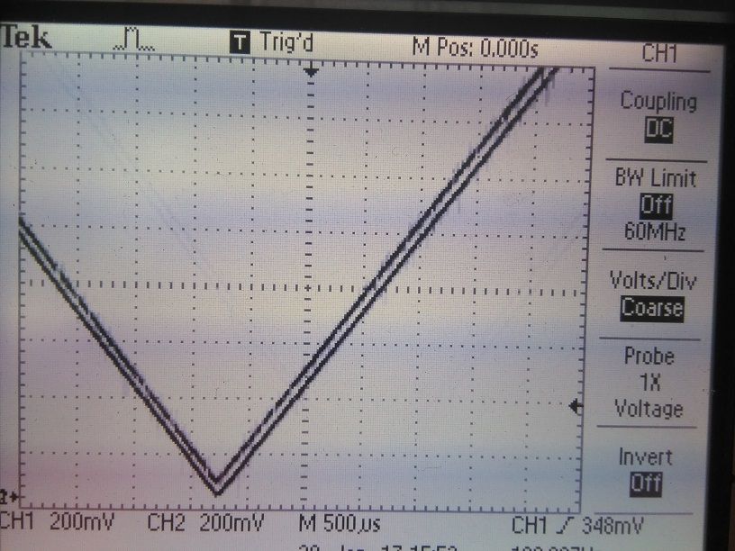

Hi, I'm new to STM32 microcontrollers, now I have STM32F3Discovery board and I want to implement a signal follower.
The microcontroller read the signal from ADC1 pin A0 and generate it on DAC1 channel2.
when I have compiled my code with stdperiph the generated signal is a perfect copy, now when I tried to use HAL library using STM32CubeMX the output signal is slightly lower than the original.

To check if the result is a carbon copy, use a debugger or dump out the gpio, adc, dac register values for both and then compare it to find clues in minutes. All the best in your debug!
2017-01-30 2:03 AM
Now I haven't good knowledge to do debugging with STM, any good tutorial to do it ?
