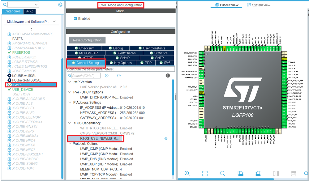

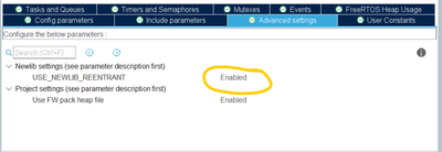

Thanks for your reply. However, I already had this setting in FreeRTOS (Enable USE_NEWLIB_REENTRANT) and it was not the solution. A representative from ST helped out with this and the picture below explains the proper setup. The setting below in LWIP General Settings, must be set to "1" and this fixed the problem.
