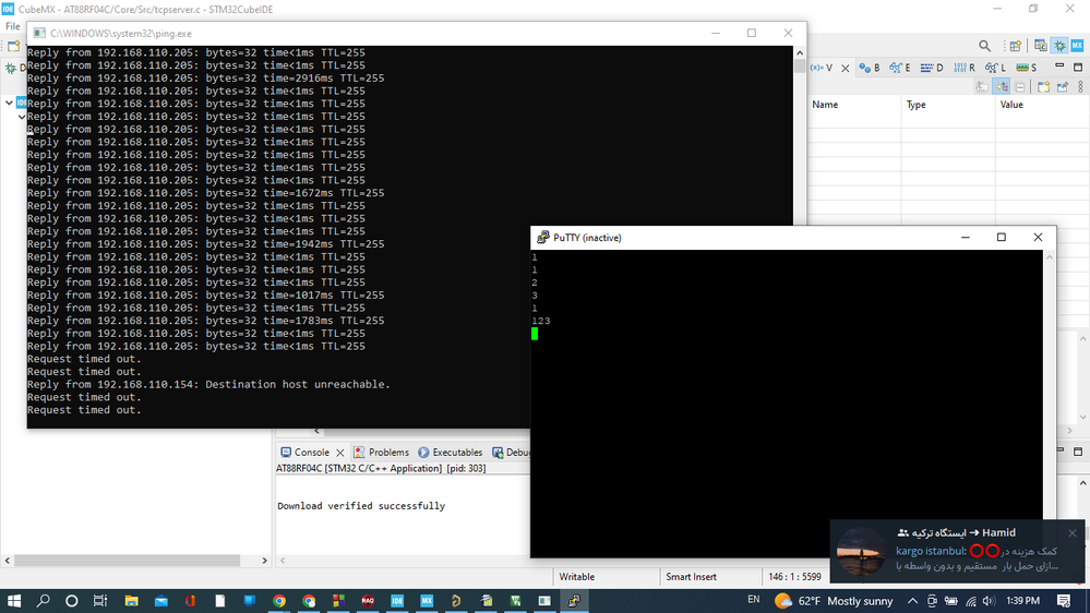

The result can be seen in the photo.
This device works well with another program written with lwip-1.3.1 and Kiel.

2022-11-15 5:52 AM
I use the CubeIDE debugger. No errors or exceptions occur, only the ping is interrupted and the network connection is interrupted. But the main loop is still running.
This happens almost after sending 8 data packets.

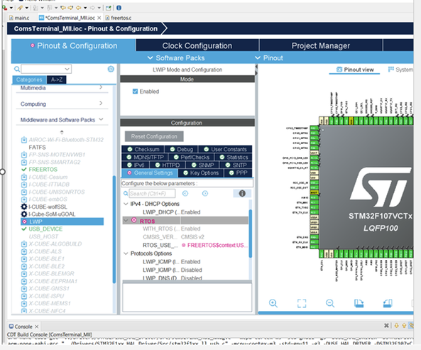

2024-03-03 7:47 AM
Does anyone know what is causing this error and how to fix it in STMCubeIDE?
Thanks!
