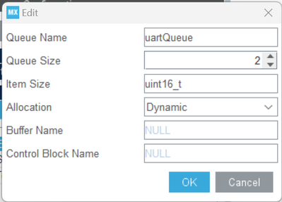

2024-03-22 12:47 AM - edited 2024-03-22 12:49 AM
@mƎALLEm Thanks for your reply.
This is my queue setting

2024-03-22 12:53 AM
Your Queue size is 2.Increase it to the length of your string.
Item size need to be uint8_t as you are sending characters.
2024-03-22 12:56 AM
@mƎALLEm I've tried to change it to uint8_t in cubeMX, but it automatically changes to uint16_t
2024-03-22 1:00 AM - edited 2024-03-22 3:09 AM
Change the Queue size to your string length.
For item size see this thread. Are you using cubemx 6.11?
2024-03-22 1:07 AM
I've tried to change the Queue size to 10, but nothing is changed.

2024-03-24 11:50 PM - edited 2024-03-25 12:29 AM
Hi, @mƎALLEm. the problem with the queue receiving incomplete messages is still there, but after I updated Cube MX, I was indeed able to change the data type to uint8_t.
