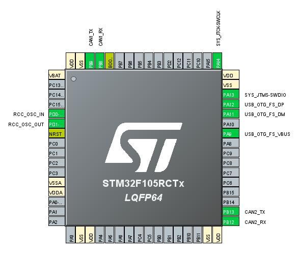

My CAN1 is connected to PB8 and PB9. And USB_OTG_FS - to PA11 and PA12.
I tried remap CAN1
__HAL_RCC_AFIO_CLK_ENABLE();
__HAL_AFIO_REMAP_CAN1_2();No effect...
2021-01-19 9:39 AM
* @brief Enable or disable the remapping of CAN alternate function CAN_RX and CAN_TX in devices with a single CAN interface.
* @note CASE 2: CAN_RX mapped to PB8, CAN_TX mapped to PB9 (not available on 36-pin package)
* @retval None
#define __HAL_AFIO_REMAP_CAN1_2() AFIO_REMAP_PARTIAL(AFIO_MAPR_CAN_REMAP_REMAP2, AFIO_MAPR_CAN_REMAP)"remapping of CAN alternate function CAN_RX and CAN_TX in devices with a single CAN interface" - why CubeIDE draw CAN1 at PB8 and PB9???
