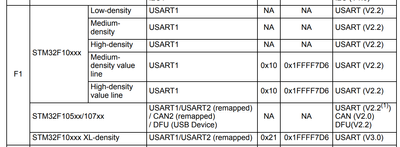

2023-09-30 10:37 PM - edited 2023-09-30 10:57 PM
So you mean that the STM32F10xxx series lacks a USB bootloader as the only bootloader listed on Page 75 is USART1? Other series do have DFU bootloader listed in their bootloader configuration. Seems there's no way to program the device in hand using STM32CubeProg and USB. I need to use this device so FTDI (to flash bin files)/ST-Link (to use STM32Cube since FTDI doesn't support debugging) are probably the only options :\
2023-10-01 12:04 AM
Yes as you see DFU is only 105 107
but MCUs with USB interface without this in system ROM, can use user coded DFU ... you test it, but not based on BOOT0 pin...
