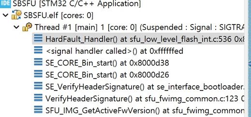

2025-07-12 3:57 AM
From the screenshot it looks like SFU software is involved, and the hard fault is expected. Have you tried to continue and let it recover?

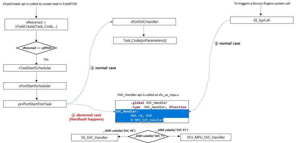

2025-07-12 4:30 AM
Hi.
I know what is problem for this issue.
But I don't know how to resolve this issue.
In case of normal, the api is called as the below.
Could you please let me know how to resolve this issue?
vTaskStartScheduler -> xPortStartScheduler -> vPortSVCHandler
void vPortSVCHandler( void )
__asm volatile (
" ldr r3, pxCurrentTCBConst2 \n"/* Restore the context. */
" ldr r1, [r3] \n"/* Use pxCurrentTCBConst to get the pxCurrentTCB address. */
" ldr r0, [r1] \n"/* The first item in pxCurrentTCB is the task top of stack. */
" ldmia r0!, {r4-r11, r14} \n"/* Pop the registers that are not automatically saved on exception entry and the critical nesting count. */
" msr psp, r0 \n"/* Restore the task stack pointer. */
" isb \n"
" mov r0, #0 \n"
" msr basepri, r0 \n"
" bx r14 \n"
" \n"
" .align 4 \n"
"pxCurrentTCBConst2: .word pxCurrentTCB \n"
But hard fault happens when SVC_Handler api is called in sfu_se_mpu.s file

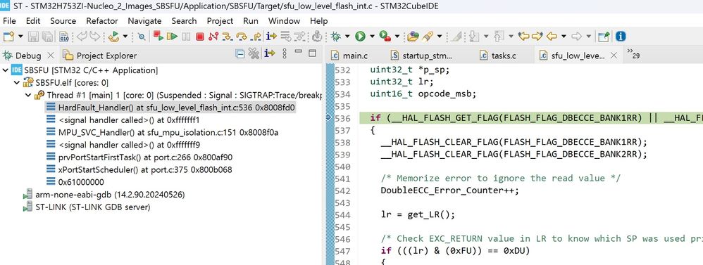

2025-07-16 10:27 PM
Hi Pavel.
I am using "STM32H753_SBSFU" demo project which is downloaded from ST.
But I want to use xTaskCreate api of freertos in this demo project.
Hardfault happens as the below.
Could you please me know how to resolve this issue?
