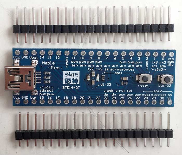

2019-05-29 12:43 AM
This is the board I'm using.
2019-05-29 12:49 AM
There is a USB reset line on one of the GPIO ports that may need to be toggled. Looking at the schematic it's on PB9.
2019-05-29 1:51 AM
Configuring PB9 as output then setting it to low solved my problem. Thank you for your help.
