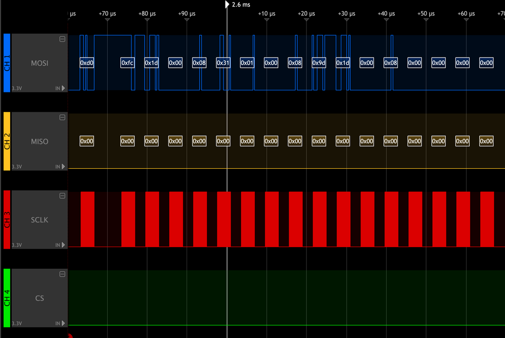

I encountered this problem when I attempted to send a one byte command using HAL_SPI_Transmit(..), and then trying to read 2 byte response from Miso, using HAL_SPI_Receive(..)
My test code is plain as follows, no intterupts, nothing connected to SPI port.

Trace on logic analyser is as seen on attached image, only the first byte 0xd0 on MOSI is transmitted by my code, following bytes are parasitics :

Edit : A further diagnosis has shown that, these parasitic transmission of bytes happen in the first 12 read cycles (1 byte each) after reset. Then on subsequent transmit/receive sequences, no more byte transmissions happen, only first one that I transmitted is emitted on MOSI. If there is residual data on Tx Buffer, does that cause this? If so, how to flush tx Buffer?

MOSI has to have a signal on it, that's how SPI works. If you care about what that signal is, for instance if you want it to be all 0x00 bytes, you can do HAL_SPI_TransmitReceive instead of just HAL_SPI_Receive. In the current implementation, in two line master mode, HAL_SPI_Receive will transmit the current content of your receive buffer. Zeroing your receive buffer will have it transmit zeroes.

Typically in an SPI transaction, there are parts where MOSI is ignored and other parts where MISO is ignored. That is probably the case here, so it doesn't matter that the buffer isn't zeroed. That information would be in the datasheet of whatever device you're interfacing with.
