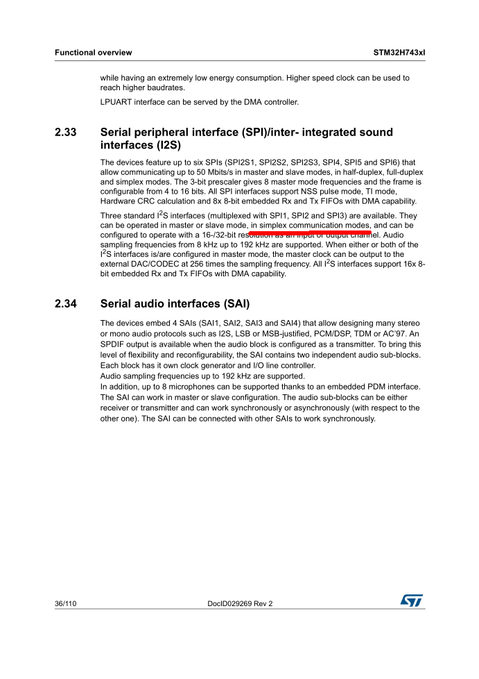

I don't use 'H7 and I don't use Cube/HAL, but isn't the SPI/I2S module simplex?
You may want to have a look at SAI.
2020-02-25 10:57 AM
The DS may be wrong... RM suggests the I2S in SPI can work in duplex.
But there may be obstacles in Cube/CubeMX:
PS. @Imen DAHMEN , can you please verify if the 'H743 I2S can indeed be used in Duplex, and if so, perhaps correct in the DS?

2020-02-27 5:21 PM
Hi Imen,
Thanks for the report on CubeID.
But, I mean, the DS, as in my first post above, says the I2S is only simplex, whereas according to RM, it appears to be duplex.
Can the DS be please checked and corrected if needed?
Thanks,
Jan
@Imen DAHMEN
2020-02-28 5:40 AM
Hi Jan,
I confirm, the datasheet is wrong. I raised your request to correct the STM32H7 Datasheets.
For example, rephrase as follow: “They can be operated in master or slave mode, in simplex or full-duplex communication modes.�?
Best Regards,
Imen
2020-02-28 5:43 AM
Thanks, Imen!
Jan
@Imen DAHMEN
2020-02-28 6:33 AM
Thanks, Imen
Takemasa
