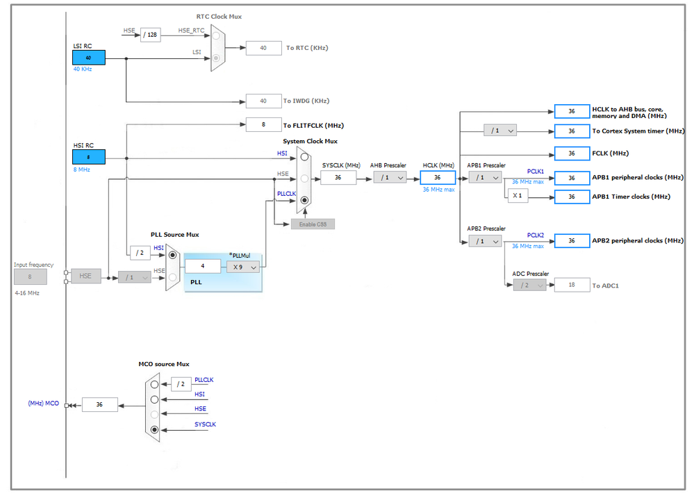

2017-02-16 3:19 AM
This is the clock configuration that works fine, created by the CubeMX.
2017-02-16 4:20 AM
That is o.k., but you need to check if the files
system_stm32f10x.c
andsystem_stm32f10x.h
match your purpose. They had usually been generated by an Excel Sheet (perhaps still found somewhere on the ST downloads) for a specific configuration. The SPL examples mostly use the same configuration (HSE, max. core clock), which is not what you want then.I suggest to step through the system init code with a debugger (or just read it), and see what it actually does and what changes you would need to make.
