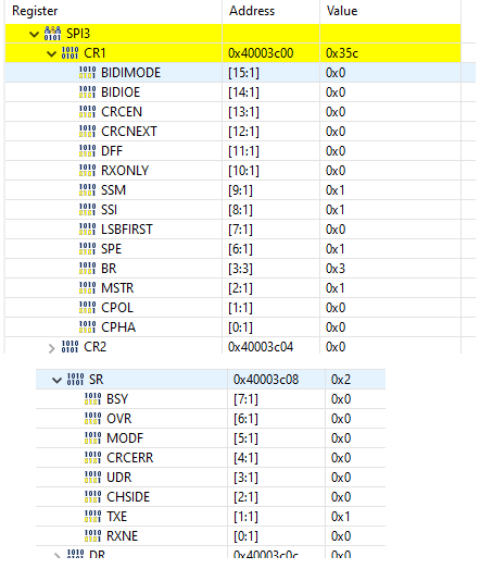

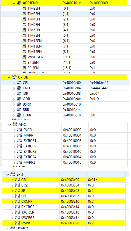

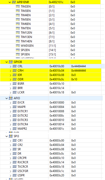

STM32 model is STM32F103RCT6
Registers before init:
Registers after SPI init:
Registers after transmit:
Is it correct?

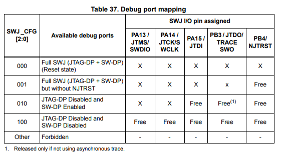

I disabled JTAG in HAL_MspInit function, so before SPI init, but...
I aslo want to use PB4 as GPIO so I added "__HAL_AFIO_REMAP_SWJ_NONJTRST();" too.
Then I have value 0x060 in SWJ_CFG register.
I find table in RM0008 where is no 011 value. So I use only "__HAL_AFIO_REMAP_SWJ_NOJTAG();" and now SPI is working.
Thank you AScha.3 and waclawek.jan for help! :)
