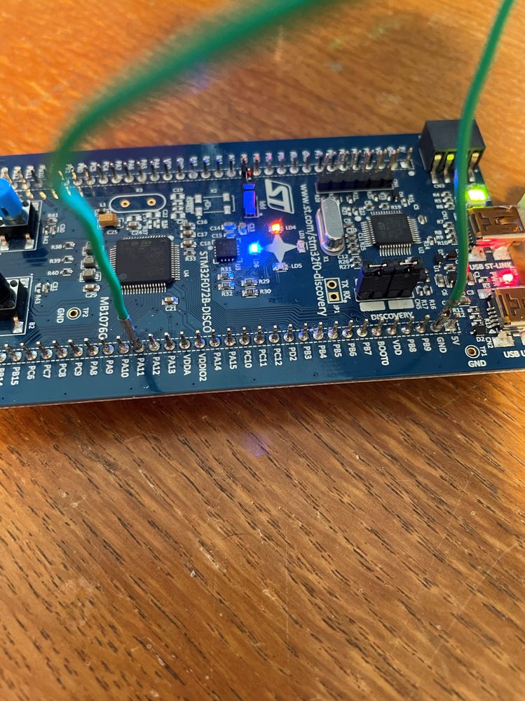

2021-07-02 7:42 AM
Hi TDK,
> IDR following the pull resistor but not your input would suggest you're not applying the input to the pin. Where exactly are you applying the flying pin?
That would be my assumption as well. It almost seems as though the pin on the board isn't physically connected to the chip. I have a lead connecting PA11 to GND on the discovery board as shown in the photo.

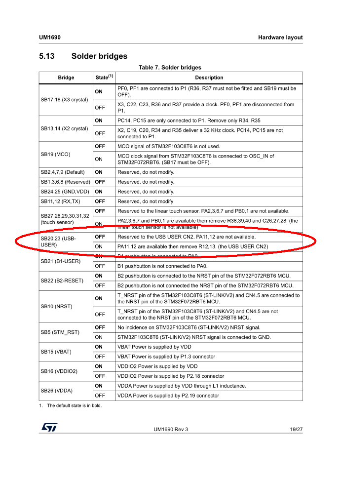

2021-07-02 7:49 AM
By default, it isn't.
2021-07-02 8:27 AM
Ah that would explain a lot. Thanks a lot for your help, I should've looked at that document a lot earlier. I'll join that bridge and report back whether it springs back to life (which I am very certain it will).

> STM32F0-Discovery board
I checked the schematic beforehand and it did not show these solder bridges.
Turns out the issue was that I was looking at STM32F0-DISCOVERY board (per the OP), whereas the OP actually had the 32F072BDISCOVERY board, despite it saying "stm32f0-discovery" on the board itself. The OP also says STM32F072xB so can't really fault.

I have joined those bridges and now have the expected behaviour, thank you both for your help it is greatly appreciated.
Apologies for any unnecessary confusion I caused, I was not aware there were 2 evaluation boards (with a similar name) and somehow didn't notice that even with the page JW linked - that'll teach me to take a bit more time reading next time.
