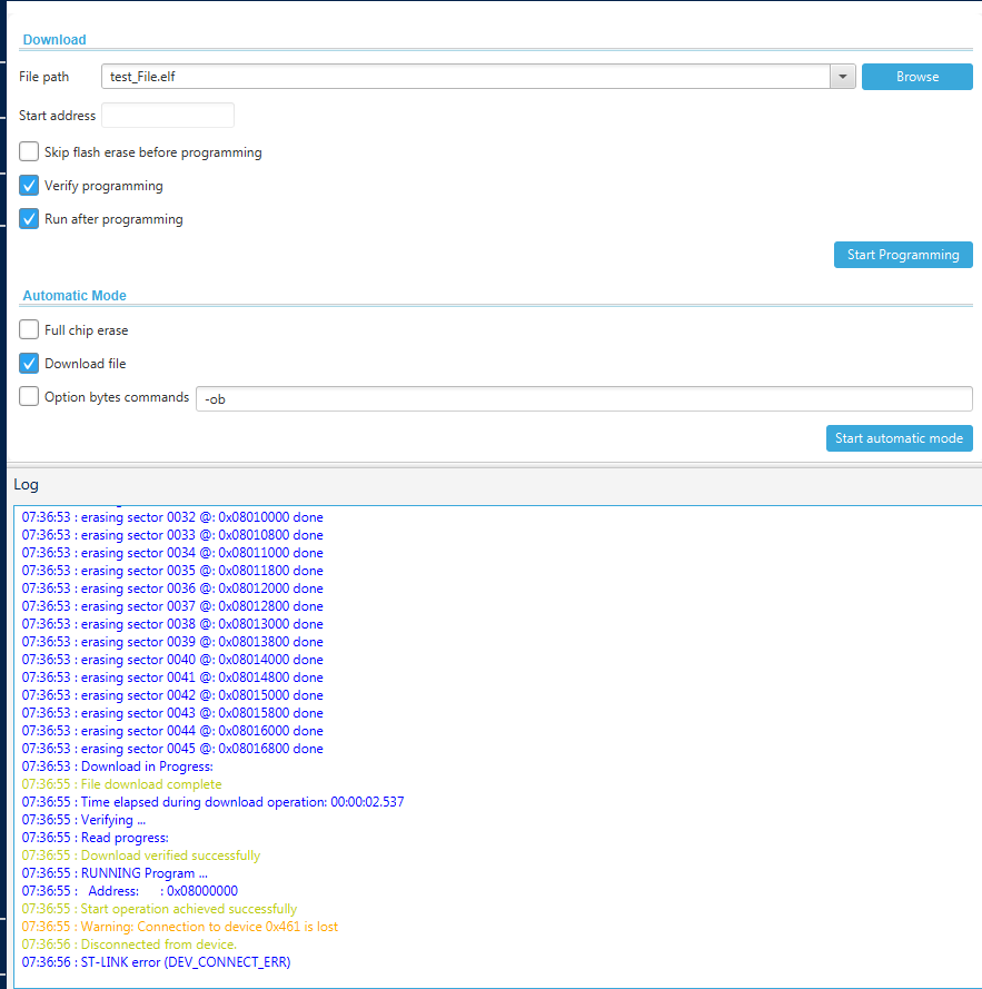

Hello, I'm running into a bit of trouble updating firmware using DFU. This would not be such a big deal, apart from the fact that sometimes an upgrade needs to be made without the ST-Link tool.
First of all, entering DFU mode and re-flashing the firmware using CubeProgrammer works.
I'm using the settings shown above.
