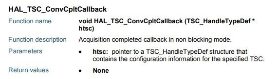

I try to generate TSC project by using STM Cube,but I am not sure how to write this function: void HAL_TSC_ConvCpltCallback(TSC_HandleTypeDef* htsc).
There is same function in "STM32Cube\Repository\STM32Cube_FW_F0_V1.9.0\Projects\STM32F072B-Discovery\Applications\TouchSensing..", but it fails on my compiler.
Can anyone share ?

The attached file is the project generated by STM Cube version 26.1. I have problem to write the function:HAL_TSC_ConvCpltCallback( ) in main.c, I don't know how to use the variable "idx_bank".
Would you please help me to pass the compiler and some TSC function works on the STM32F072Disco board?
