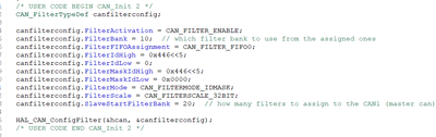

Hi Karl!
Thankyou for the reply, my filter settings:
My aplogies I didnt think these were important at this stage as I was trying to get my transmission working from the peripheral first.
