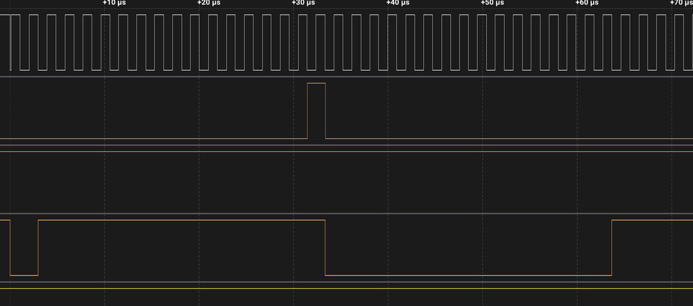

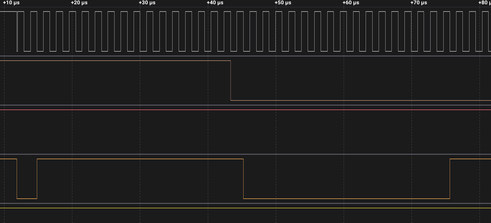

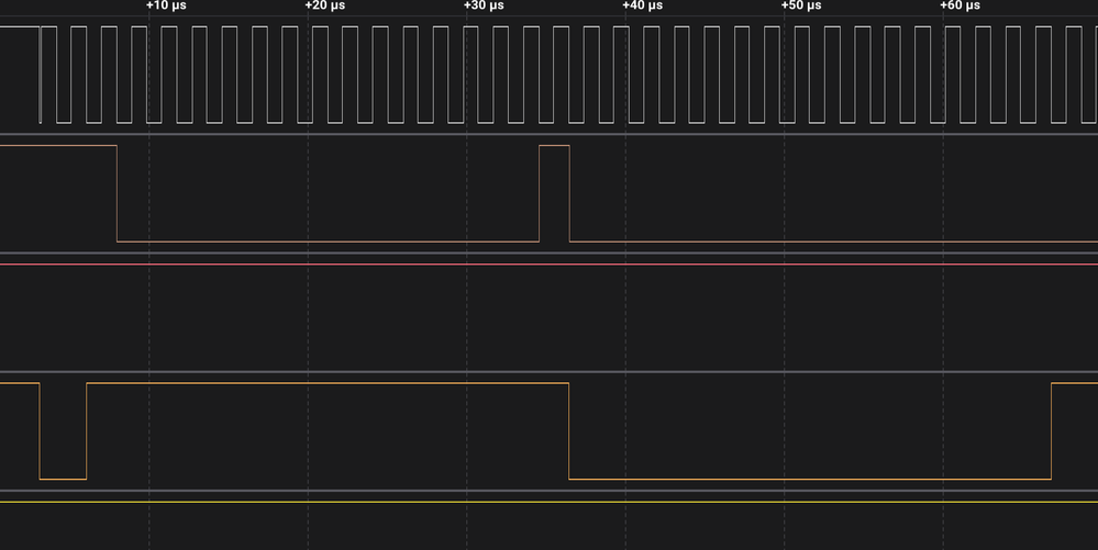

2024-12-30 1:09 PM
Thanks for the reply.
I already struggled with some edges during initialization - whole transmission was shifted by 3 bits. If I remember correctly I applied your suggestion about clock value from someone else's topic.
There are still indeed some extra edges in the beginning, but I suppose they are somehow discarded by STM - WS line does not go high during their period and after that, there are exactly 16 clock cycles during first '1'. I think that it would also cause shift of all of data - not only the least significant bits by a packet size.
Either way, I attached some LA captures below. To make it readable, I cropped two last packets - there were zeroes only, so nothing unexpected happened.
Data sent: 0x8001 0x0000 0x0000 0x000 0x8001 0x0000 0x0000 0x0000
Data sent: 0x0001 0x0000 0x0000 0x000 0x0001 0x0000 0x0000 0x0000
Data sent: 0xFFFE 0x0000 0x0000 0x000
0xFFFE 0x0000 0x0000 0x0000
